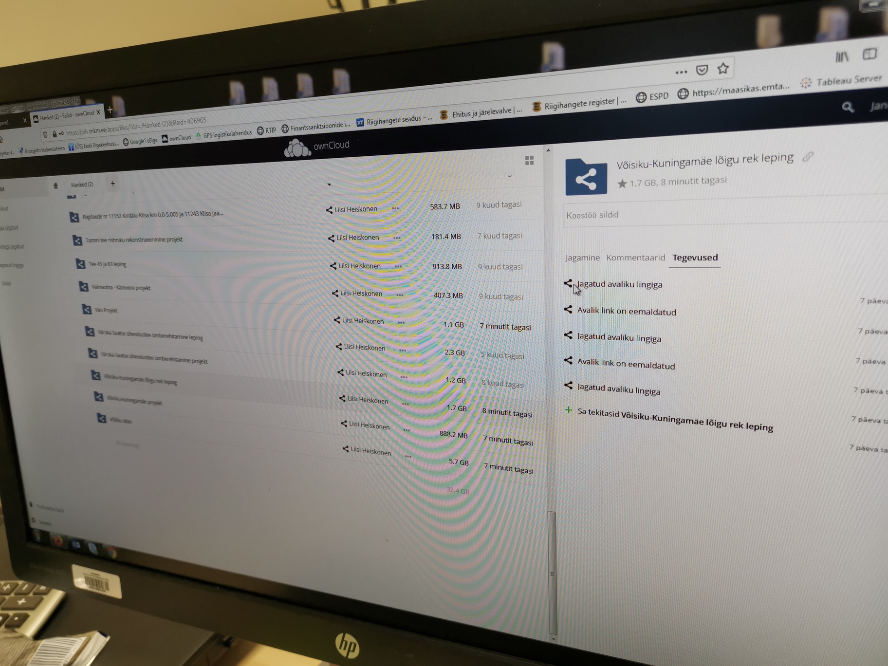

attached screenshots to show the owncloud information on links (should be information when it is removed or the link times out)
The added pictures show that the log shows like the folder has been shared with a link but the link can not be found on anywhere (not the main user nor any users who also can see the folder).
