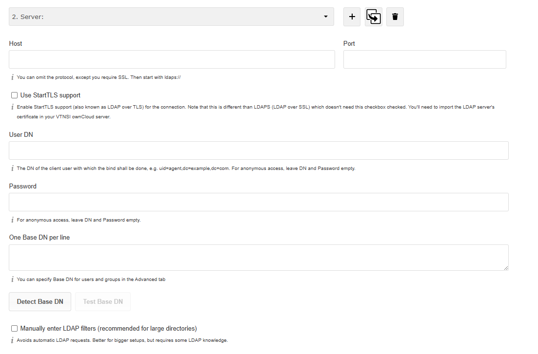

Owncloud 10.15.2 Multiple AD authentication attempts causing locked account when bad PW entered.
  1. Log into locally hosted owncloud using bad PW.
  2. Owncloud attempts to authenticate with AD 3 times per LDAP server configuration
  3. Account locked due to AD policies locking after 5 failed attempts.

LDAP configuration (delete this part if not used)
With access to your command line run e.g.:
sudo -u www-data php occ ldap:show-config
from within your ownCloud installation folder
| Configuration                 |                                                                                                                                         |
| hasMemberOfFilterSupport      | 0                                                                                                                                       |
| hasPagedResultSupport         |                                                                                                                                         |
| homeFolderNamingRule          |                                                                                                                                         |
| lastJpegPhotoLookup           | 0                                                                                                                                       |
| ldapAgentName                 | ***REMOVED SENSITIVE VALUE***                                                                          				  |
| ldapAgentPassword             | ***REMOVED SENSITIVE VALUE***                                                                                                           |
| ldapAttributesForGroupSearch  |                                                                                                                                         |
| ldapAttributesForUserSearch   |                                                                                                                                         |
| ldapBackupHost                | ldaps://***REMOVED SENSITIVE VALUE***                                                                                                   |
| ldapBackupPort                | 636                                                                                                                                     |
| ldapBase                      | ***REMOVED SENSITIVE VALUE***                                                                                                		  |
| ldapBaseGroups                | ***REMOVED SENSITIVE VALUE***                                                                                                		  |
| ldapBaseUsers                 | ***REMOVED SENSITIVE VALUE***                                                                                            		  |
| ldapCacheTTL                  | 600                                                                                                                                     |
| ldapConfigurationActive       | 1                                                                                                                                       |
| ldapDynamicGroupMemberURL     |                                                                                                                                         |
| ldapEmailAttribute            | mail                                                                                                                                    |
| ldapExperiencedAdmin          | 0                                                                                                                                       |
| ldapExpertGroupnameAttr       | cn                                                                                                                                      |
| ldapExpertUUIDGroupAttr       |                                                                                                                                         |
| ldapExpertUUIDUserAttr        | objectguid                                                                                                                              |
| ldapExpertUsernameAttr        | sAMAccountName                                                                                                                          |
| ldapExposedAttributesForUser  |                                                                                                                                         |
| ldapGroupDisplayName          | cn                                                                                                                                      |
| ldapGroupFilter               |                                                                                                                                         |
| ldapGroupFilterGroups         |                                                                                                                                         |
| ldapGroupFilterMode           | 1                                                                                                                                       |
| ldapGroupFilterObjectclass    |                                                                                                                                         |
| ldapGroupMemberAlgo           | groupScan                                                                                                                               |
| ldapGroupMemberAssocAttr      | uniqueMember                                                                                                                            |
| ldapHost                      | ldaps://***REMOVED SENSITIVE VALUE***                                                                                                   |
| ldapIgnoreNamingRules         |                                                                                                                                         |
| ldapLoginFilter               | (&(&(|(objectclass=person))(|(|(***REMOVED SENSITIVE VALUE***)(primaryGroupID=513))))(samaccountname=%uid)) 				  |
| ldapLoginFilterAttributes     |                                                                                                                                         |
| ldapLoginFilterEmail          | 0                                                                                                                                       |
| ldapLoginFilterMode           | 1                                                                                                                                       |
| ldapLoginFilterUsername       | 1                                                                                                                                       |
| ldapNestedGroups              | 0                                                                                                                                       |
| ldapNetworkTimeout            | 2                                                                                                                                       |
| ldapOverrideMainServer        |                                                                                                                                         |
| ldapPagingSize                | 500                                                                                                                                     |
| ldapPort                      | 636                                                                                                                                     |
| ldapQuotaAttribute            |                                                                                                                                         |
| ldapQuotaDefault              |                                                                                                                                         |
| ldapTLS                       | 0                                                                                                                                       |
| ldapUserDisplayName           | displayname                                                                                                                             |
| ldapUserDisplayName2          |                                                                                                                                         |
| ldapUserFilter                | (&(objectClass=person)(***REMOVED SENSITIVE VALUE***))                                                      				  |
| ldapUserFilterGroups          |                                                                                                                                         |
| ldapUserFilterMode            | 1                                                                                                                                       |
| ldapUserFilterObjectclass     | person                                                                                                                                  |
| ldapUserName                  | samaccountname                                                                                                                          |
| ldapUuidGroupAttribute        | auto                                                                                                                                    |
| ldapUuidUserAttribute         | auto                                                                                                                                    |
| turnOffCertCheck              | 0                                                                                                                                       |

We currently have a bind username set up, but it still attempts to bind with the user who is logging in. Is there another setting that needs to be set to use the bind that is configured in the “LDAP\Server” section of “User Authentication”? Or am I configuring the wrong setting?
These fields are filled out in our current configuration and when testing the base DN, it returns a list of users as expected. Indicating the success of the “User DN” and “Password”.
I will set the strict login as well to enforce the system to not attempt to use an email log in.
That’s fine. In your last screenshot, the user there (usually a LDAP admin) is used to get access to the information. We’ll need to bind that user to get access.
For the login user, we still need to bind with that user just to verify the password.
I guess you’re expecting that the “admin” user gets the information about the login user from LDAP (specially the password) and then compares whether the LDAP password for the user matches whatever password the user has entered. ownCloud does NOT authenticate against LDAP that way. ownCloud will try to bind the user with the supplied password; if the bind is successful, the user is logged in in ownCloud, otherwise the login is rejected.
Thank you for the insight. I will set “strict_login_enforced => true” in the config file and that should help us move forward without so many users getting locked out after their first failed password.
