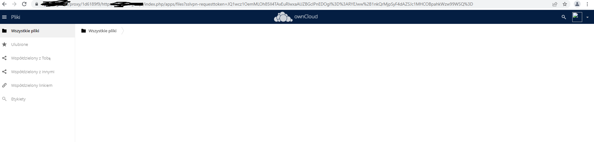

When connected via SSL VPN Portal to ownlcoud placed in our domain, user files cannot be seen. Apart from SSL VPN, owncloud works without problems. I am enclosing a dump of the problem that is occurring. Maybe it’s by changing the address?
The proxy you are using is most likely using HTTP Basic Authentication. It is not supported to run ownCloud behind that, as it is using this internally. Perhaps you can switch to a different authentication method for this website?
