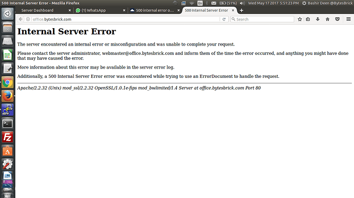

I am facing problem with owncloud file upload size. Today i updated “> Maximum upload size ” in admin of owncloud but after changing this my website is down and it’s showing 500 internal server error found. So i am not able to change that parameter back. Please suggest me “How can i get back my site live with owncloud ?”

i just changed the upload limit from 512MB to 4GB by admin portal of oc and after it i got this error 500 internal server error page.

i got this error since i changed the value of file upload size in admin panel from 512MB to 4GB.
