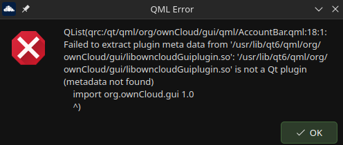

Bug in Owncloud regarding QT (i guess)
OwnCloud Client should open
Giving this error:
  1. Install the newest OwnCloud client in Arch Linux
  2. Open
  3. See the error

AFAICT if there is a bug in ownCloud you would need to report them on GitHub instead for higher chances that it will get noticed by the ownCloud team.
The owncloud client is being built and tested with qt 6.8 - arch uses a higher version of qt which we do not support.
Okay sounds great. What is the status of this? I am on Owncloud 6.0.1 which is working
@mbs1337, you should report the version mismatch to the Arch packager:
This package should have prevented your OS upgrading, because it should be restricted to compatible dependencies.
