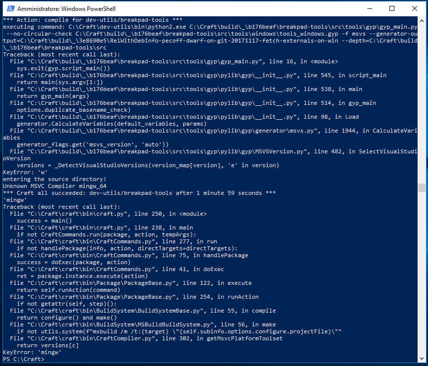

I don’t know if am in the right spot after build but that’s what kind of error I get now:
Any ideas?

@timetofaceit I did it but I got the error during the building process. At least you completed this step. Can you tell me all your steps before the building process and your configuration? Thanks
@salvatoreucchino @timetofaceit Maybe check the new documentation pull request from @dschmidt about building the client with Craft:
We’d love to hear your feedback! Is there something that needs more detailed explanation?
Thank you @michaelstingl and @dschmidt. I’ll follow new doc and I’ll keep you updated.
I followed steps of new doc and…it worked perfectly! Thank you guys. Just one more question: if I want to make some changes and rebuild the client to see them, what do I have to do?
Fork the client repo on GitHub.com, then build from your repo. (keep submodules)
