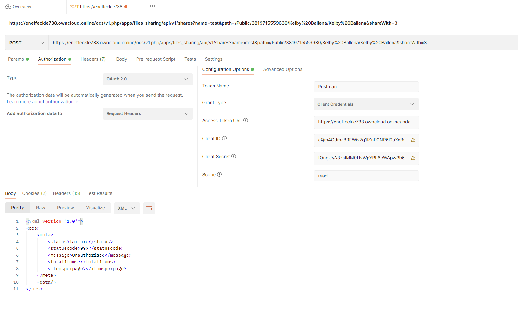

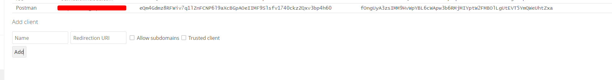

Thanks, Eneu Bauer.
Can you please tell me what’s wrong with it?
Can you try using an app password?
how to set up the app password? I tried with my account password, it also doesn’t work.
Go to the settings panel, personal security section. You’ll find it at the bottom.
