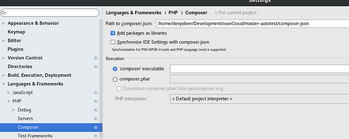

did you setup composer.json properly within phpstorm?
thanks DeepDriver1975, i’m solved
I thought of a composer when i saw your upload image
but I thought the dependencies were well-installed because I had already used the “make” command you told me.
but in the end, It was a composer problem.
I installed a composer and used the composer install command, and when a lot of files were downloaded, the red pimple letters naturally turned black.
