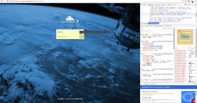

The I checked the page HTML code and found that the submit button has disabled=“disabled” (<input type="submit" id="submit" class="login primary icon-confirm" title="Log in" value="" disabled="disabled">) and I deleted it. Then I could login, but now the problems is that all the links/buttons in admin’s page has no links (href=“#”).

When I delete (using Chrome’s Inspect funccion) the disable=‘disabled’ from input I am able to log in but have blank content with all links disabled.
