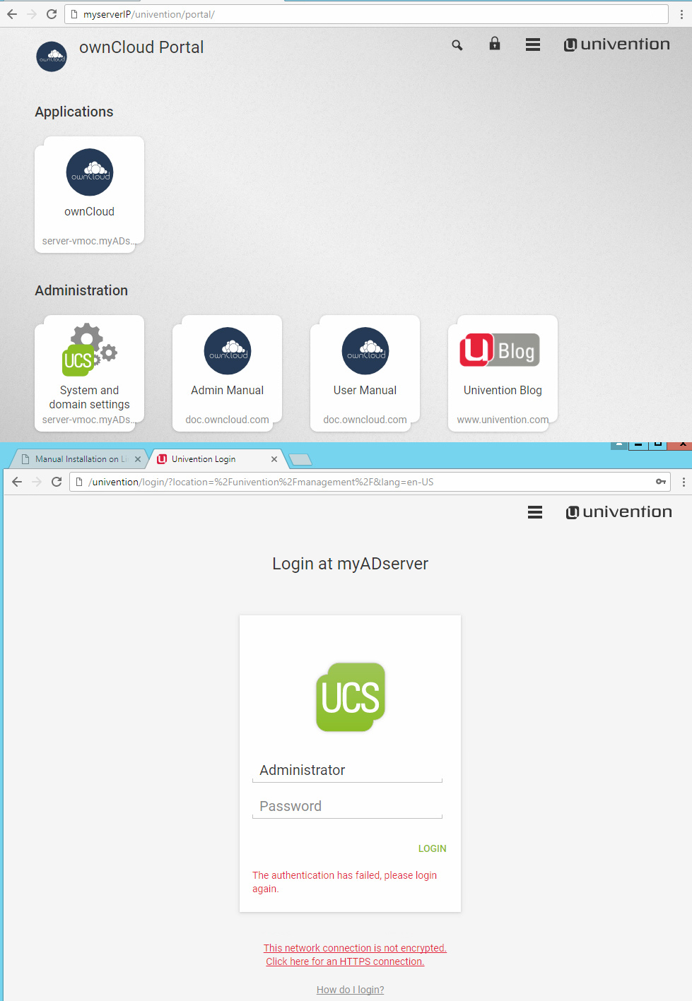

Virtualbox is running on a physical WS 2012 server, and I’m seeing as the screenshots below (sorry for two-in-one, the board doesn’t allow me to post more than one image.
The top part is what I’m seeing when accessing owncloud’s server IP address. Under “Applications”, the ownCloud “application” accepts all AD logins and owncloud/owncloud.
The bottom part is the login page that appears after clicking, under “Administration” > “System and domain settings”, and this is what I get when using the Administrator login details (root password).

The issue is that the “Administrator” user, using the root password defined during the appliance setup, fails to login:
The authentication has failed, please login again
