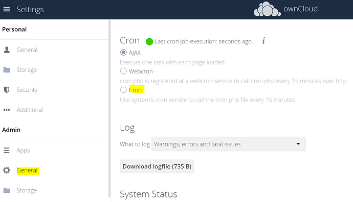

You could just use the webUI, right?
This check is basically a security feature. You can turn it off or exclude directories from this check in your config.php.

Thanks for all the answers otherwise. I knew I could set the cron from the UI but I believe it was erroring. I just set it again and will check back tomorrow to see.
Ben
So I did turn it on yesterday and as I remembered, I am getting these errors so I can clearly not use it. Do you have any idea why?

AFAIK to be able to use “Cron” you need to have a cron job running on this system (see the related documentation). Just switching to this setting won’t enable this automatically.
