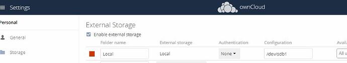

NOW i am trying to configure a Physical Disk on my Host Server with some content as an External Storage in OwnCloud.
  • Attached the Physical Disk to the VM running OwnCloud
  • Verified the disk is automatically mounted and contents inside are accessible
  • Enabled External storage in OwnCloud portal
  • Ammended the Config.php of owncloud with below entry to enable the Local storage
    ‘files_external_allow_create_new_local’ => ‘true’,
  • Verified the portal now lists the Local
  • Tried to add the disk as storage but it does not get successful
Not able to understand what i am missing or doing wrong :frowning:

i don’t think that the “/dev/sdb1” path is correct. From what i know this is a special device on linux which you can’t browse “as is”:
cd /dev/sda1
bash: cd: /dev/sda1: Not a directory
The same probably happens for ownCloud as well. Maybe it helps you to choose the correct input for the “Configuration” box when having a look at the ownCloud documentation about local storage:
https://doc.owncloud.org/server/latest/admin_manual/configuration/files/external_storage/local.html

Yes. Problem is I don’t know what to write in the Configuration field.
The local part clearly works because if I write only / in the configuration field than i get everything in that folder.
i’m not sure if others are able to tell you what you need to write into the configuration field without knowing what you’re trying to do / knowing your environment. :slightly_frowning_face:
Well, it’s not that difficult, at least not after skimming the related docs. :wink:
Configuration field contains either the mount point, where you attached the physical drive to the filesystem or a path of a directory outside ownclouds data directory.
I might be wrong, but I have verified both variants.

I managed to get the drive listed with fdisk -l .
Than I formatted it to ext3.
Than I mounted it to /data/930GB.
I changed the permissions on that dir to 755.
I created this external storage local thing, but it doesn’t work… I get that red square thing before it.
What can I do?
you could try to check your owncloud.log if you can find any hints / errors which you could use for further research on this issue.
