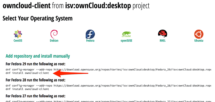

I also added the repo:
sudo dnf config-manager --add-repo https://download.opensuse.org/repositories/isv:ownCloud:desktop/Fedora_29/isv:ownCloud:desktop.repo
Please follow this instructions:
I already tried it … it doesn’t work ;(

You are getting owncloud-client 2.4.0 from some fedora server.
All the packages coming in are i686 binaries. That indicates you installed a 32bit system.
We don’t have packages for 32bit systems. Only 64bit on our repos. sorry.
