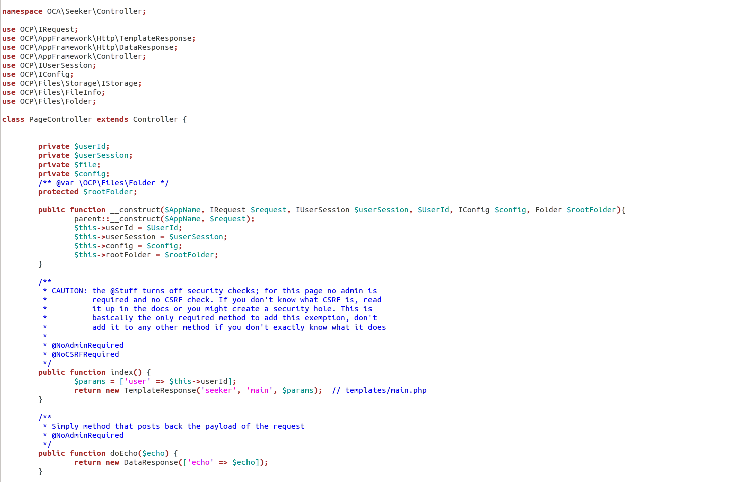

I try to create a new apps but since the beginning something is wrong.
When I tried to modify the controller part, I can not instanced Files Class.
Here a exemple with OCP\Files\Folder :
This is my code very simple :

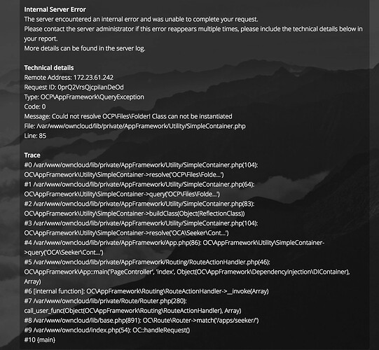

And this is the result :
The same thing happen when I use OCP\File\FileInfo or OCP\File\Storage\IStorage.
Any idea or suggestion to resolve this very annoying issue ?
