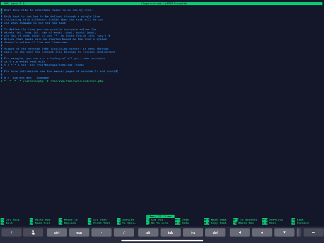

This is what my crontab looks like for use www-data
i’m not sure if it makes much sense to add the crontab entry like this for the root user and then use sudo to run it as www-data. Maybe this is already the problem, have you tried to add this entry without the sudo call to the www-data user?
I also think that there could be logging done into the syslog where you could see why the cron run doesn’t happen.
The “Desktop” category is looking wrong to me as well (not sure why this category was chosen for a Server configuration problem? :frowning_face:), maybe you could edit your post and put the topic into the correct "Server category?
You should do it this way
https://doc.owncloud.com/server/10.0/admin_manual/configuration/server/background_jobs_configuration.html#cron
Regarding cron jobs there are a few things to know/do:
  • There has to be a line break at the end of your cron line
  • Due to this, never ever edit your cron file on Windows, they are using line breaks incompatible with Linux
  • Many distributions configure cron to send an email to the root user if there is output on stderr
  • If you don’t have an email configured for root you can redirect your stdout and stderr to a logfile by appending the following: 2&>1 >> /path/to/folder/writable/for/apache-user/cron.log
  • The apache user is called www-data on Debian/Ubuntu, apache on CentOS/RHEL
  • Cron jobs run as sh and not as bash usually
  • To get an identical environment run the command env in a cronjob and write its output to a file, then source that file. Afterwards try rerunning the cron, now you should definitely see the error.
