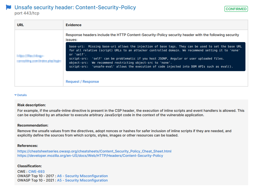

I have a server that is running OwnCloud 10.15.0.2. The server is running fine and there are no issues specifically with it’s functionality. However, a recent scan has listed a low level issue related to CSP that I am trying to resolve. I have uploaded a screenshot of this issue.

That did make it so the CSP I was generating was the one displayed in the headers. However, this config had some issues and removed the configuration. I have 2 questions that I hope someone can answer:
  1. Am I correct that there is no way within the application to update the sites CSP, even with some third party plugin?
  2. If the CSP can be edited either via nginx or some application method, Is there a way to configure CSP so that it will resolve the issues shown in the uploaded attachment without breaking the site?
