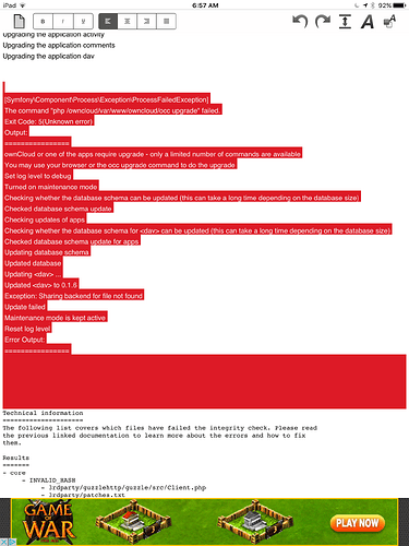

This is the exact error from GUI, if it is not enough i'll rerun the update (put snapshot back now) and reproduce let me know. I checked dav app version and it seems to be running 0.1.6, can't disable it for the update. Little cautious too as this is a production environment (our company is evaluating the product).

Where are those "e" are coming from? Especially this doesn't look right:
e Updated eeee to 0.1.6 e
Rtf characters appearantly. Please see picture for exact output.
Ahhh, got it. I've assumed that the output was stripped because those "e" where at the end of each line.
