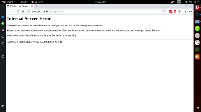

  3. reload owncloud page
  4. error page is shown on the screen
Tell us what should happen
the page should load normally and save biggest website files on the computer reaching out to the website.
Tell us what happens instead
the server drops into the error page

Can we see a screenshot? Or some error messages from the logs?
in the owncloud.log file there isn’t said anything about this error.
anything in the apache logs?
nope nothing there either…
are you sure the apache config is done right? just asking - I’m out of ideas.
I just did a complete reïnstall, which took me a day to reconfigure, but it’s working again. No idea what the problem could have been…
