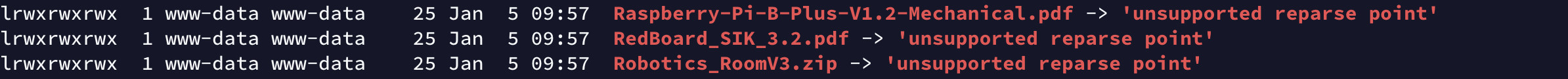

An ls -al Of the directory shows:
What’s with that? Newly created folders and uploaded files within this folder (the one I’ve migrated) don’t show this.

The unsupported reparse point is what you need to find out.

I think the file is not really there. There is some kind of link, that doesn’t really work. Perhaps you have some way of analyzing, where that link was supposed to point?
I don’t think this is a thing ownCloud needs to fix. I think if you downloaded that file through say sftp it would also be corrupt.
I wish that were true. The very same file that I copied from the portable hdd to the owncloud server is there and working correctly, from the hdd. Ill try unzipping the same file on the server…
I guess you’re right! Super weird. I wonder how and why this happened.
