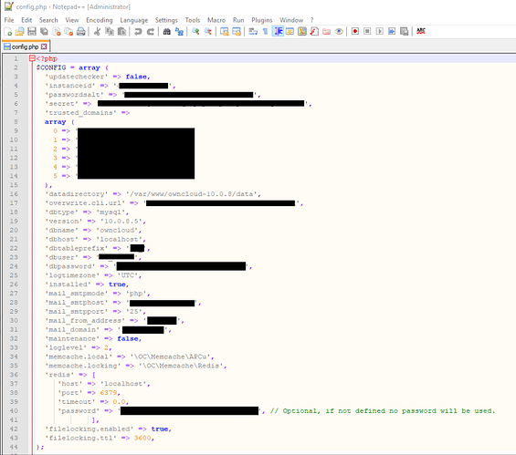

This is my config.php
I got it to work. Re-read the instruction and found that redis is not enough. I’ve not read that Redis needs phpredis installed as well!
There was no problem with config.php at all.
