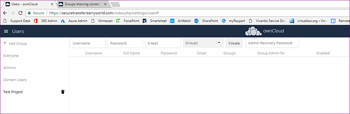

Having just gone back in, the numbers no longer show either. See the screenshot below. This is the same for both LDAP and Database added users.

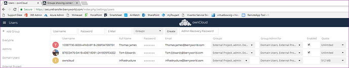

This is how our users are currently set up. There should be three users showing in the group (1 x Database, 2 x LDAP).
Can you show me the users tab with “everyone”?

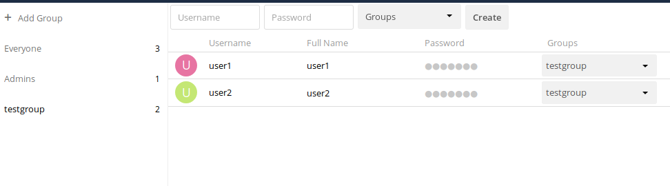

Created the test users (locally) with same result. They end up in the groups BUT the groups remain blank and the numbers also don’t populate.
