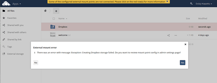

Hello, I was able to setup the development environment and also created the dropbox app by following the instruction given in Dropbox setup
But there seems to be some error because the dropbox storage could not be mounted properly. Dropbox Error
Here is the response sent by the backend server

I suggest you check the owncloud.log for possibly more detailed error messages. Maybe you didn’t setup the Dropbox app properly.

I was able to resolve above issues myself by setting up HTTPS, enabling SSL on my local apache server. Then I enabled memory based locking using Redis also. Now there are no errors in the settings page. But when I click on the Dropbox folder in the Dropbox files app, I get the following error.
@PVince81 Can you please help me with this error?
