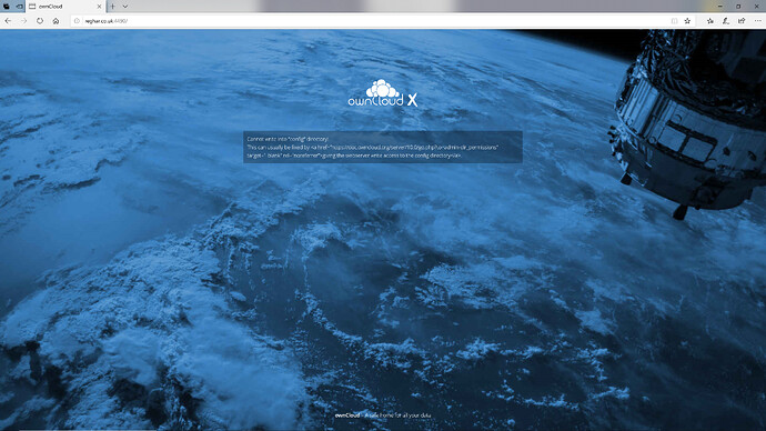

It nows comes up with this
The log file is blank. If I set it to 0777 it makes no difference.

#5
Cannot write into the “config” directory
Now you know the problem, and the solution is quite obvious (ownCloud needs to write in the config directory). As for how to reach the solution, I can’t help much since I’m not familiar with that setup.
You might want to ask in any qnap forum to check how ownCloud is setup and how you can give the required permissions to ownCloud to run

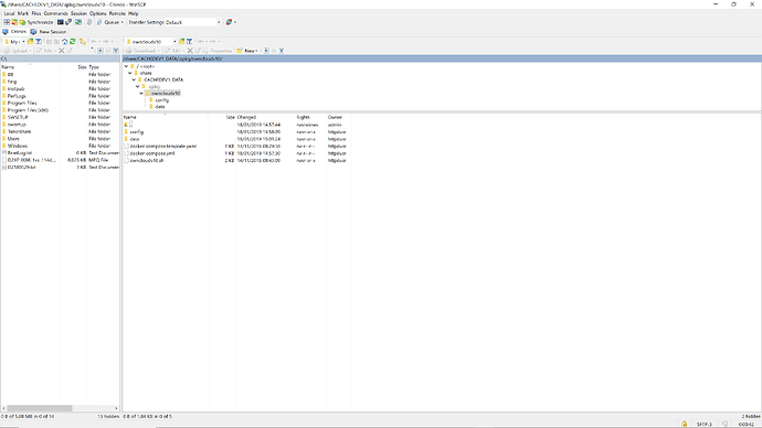

#6
Ok you state that it is obvious, I would agree but the access rights have been set to the same as the rest of the folder. So owncloud can enter database and data folder but can’t edit config … just weird.
#8
If it’s using docker, the user being used by ownCloud might not be httpdusr but another. That’s why I suggested to use 0777 permissions: so ownCloud can write into the directory and you can check the user being used by ownCloud. After that, you can adjust the permissions so ownCloud is the only one having access there.
