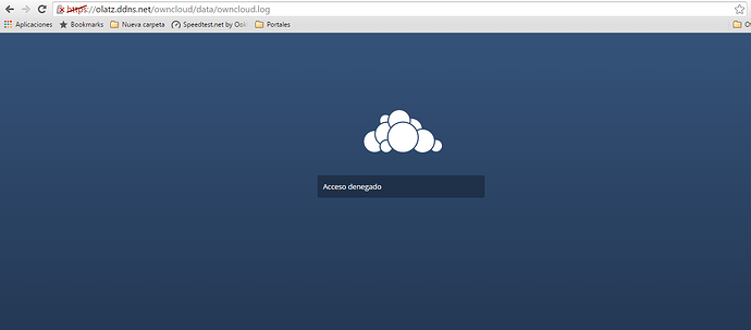

I don’t know, if I try to open it from the browser I get a message saying: acces denied:
But if I open it in the shell as root the file is empty.
Yes, it’s not possible via browser directly (an attacker could gather interesting information from your logfile). Only the admin can see it on the admin page.
Now, you have directly retrieve the logfiles from your folder (login via ssh/ftp/…)
