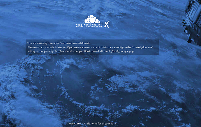

Hi dmitry,
The install has succeded, but when i try to access to the web page, I can not connect and had a message…(see screenshot jointed)
The config.php file is already edited with the right informations
How can I do to solve this please?
please add the IP address you are trying to access owncloud from to the trusted domains in config.php
https://doc.owncloud.com/server/10.0/admin_manual/configuration/server/config_sample_php_parameters.html?highlight=config#default-parameters
