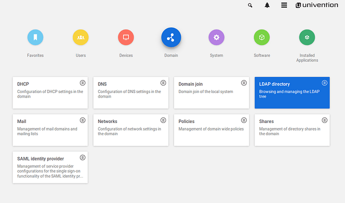

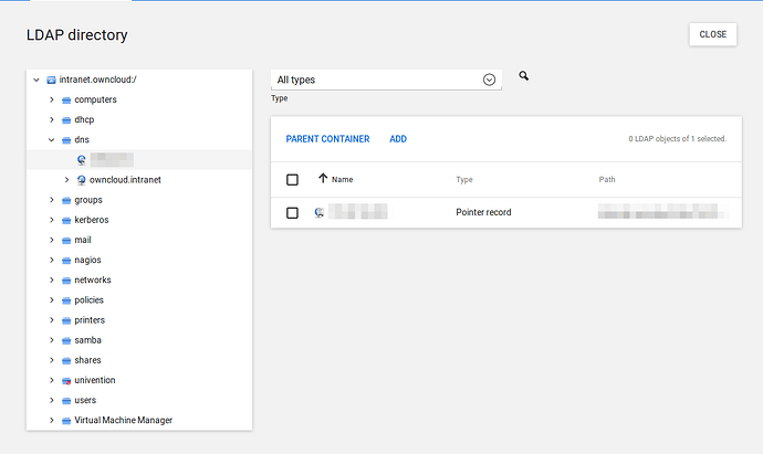

Try in the ownCloud LDAP settings.
Or you could try to go in the UCM and there to enter the LDAP settings, and change there the DNS entry, that probably still has the old IP Address mapped to the domain name.

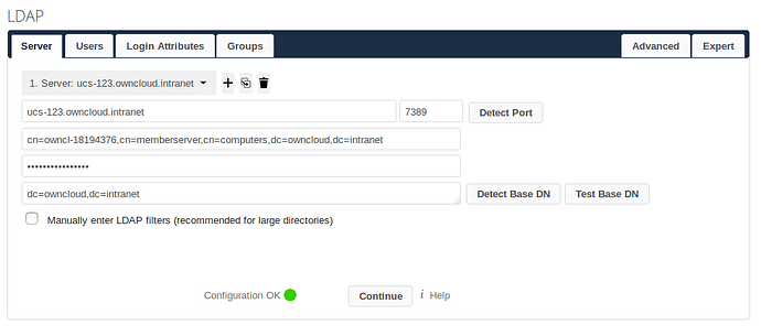

do you mean this one?
of this one:
Because I meant the second one. User Authentication. There you can adjust the your LDAP server settings.
It is the first one that I cannot go to.
yeah. that’s because you need to change the settings of the second one
Edit:
Tested. I started a Appliance at work, went home, changed the IP address, and could not access the users tab in ownCloud.
Went to user authentication, changed the domain name of the LDAP server to the new IP address, and it worked.
