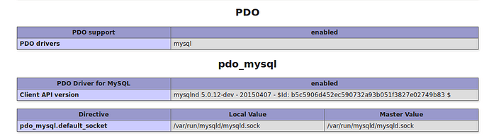

You can’t use php -m on command line to check if the needed modules are loaded within your webserver. Those are two completely different things.
Use a phpinfo instead to see if the PDO and pdo_mysql drivers are loaded.
OK, I checked with phpinfo.php
Has nobody an idea how I can solve this problem?
This should imply that the database connection is working. My PDO drivers also include sqlite (even though I’m not using a sqlite database), can you post the mysql*-section as well?
