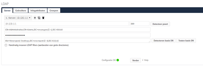

I hope I found the correct information;
I re-added the group before taking these logfiles. Hope that would trigger anything;

Check the size limit of your AD. View and set Lightweight Directory Access Protocol (LDAP) policy with Ntdsutil - Windows Server | Microsoft Learn
The MaxPageSize of the AD must be greater than the “paging chunksize” configuration of the ownCloud’s LDAP app (in the advanced tab of the ownCloud’s LDAP wizard)
It’s the same. The AD MaxPageSize is 1000 and ownCloud’s Paging ChunckSize is also 1000.
Should I change the size of this on the ownCloud page, to for example 500?

Do I have to do anything else afther I changed this? Because it still doesn’t seem to work?
Check the logs to see if there is any other error that could be showing. The “size limit exceeded” one should be fixed.
It’s also helpful if you post your LDAP configuration (removing the sensitive parts)
Here are parts of the log. There is another size limit exceeded message in it;
