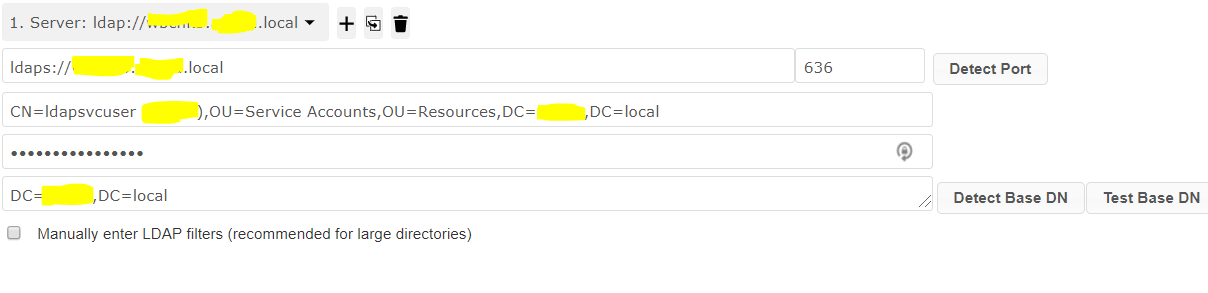

And this is on the owncloud server:
This settings is not working.
Do you guys see anything special?
