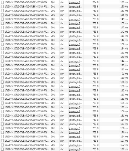

I needed to create a cloud storage with folders that were protected from deletion. I implemented this on the external storage of SAMBA (with ACL) and sticky-bit “t”.
This solution works fine, except for speed. If I upload one large file to the external storage of Samba via the web interface Owncloud, then everything is normal - the speed is about 5-7 Mb/sec. But if you try to upload a folder with 50 files at 10kb, then it will be uploaded during 3 minutes!
The network log of the browser shows that the query processing 3.5 seconds for each file.

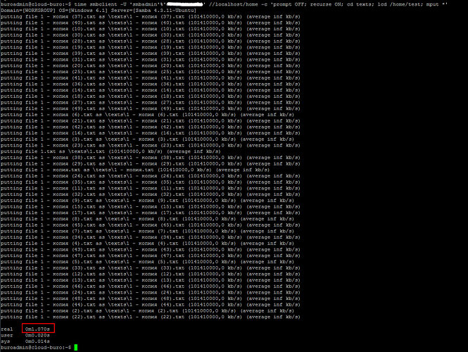

I thought the problem was in Samba, but connecting to it directly from Windows, the test folder was uploaded in 3 seconds.
