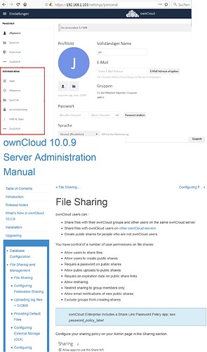

maybe it could help if you could provide a screenshot where you’re looking for this sharing option and a link to the documentation you’re looking at for this sharing option?
I have added two pictures, first where i would expect what is described in the second picture, which is from the admin manual.

Can you check in the apps section if the files_sharing app is installed?
strange enough i’m also not getting the “Sharing” Icon shown on 10.0.9/10.0.10 within the admin section even with the “Share Files 0.11.0” app enabled. I’m pretty sure this was there some versions ago.
But if i’m accessing the following link directly (luckily i had this in my browser history) i’m getting the settings presented:
https://example.com/settings/admin?sectionid=sharing
Ok, i did the obvious step first and used another browser (Chrome) which is showing the “Sharing” section icon just fine. After restarting Firefox with disabled addons i also get the icon shown.
So it seems to me some browser addons / settings are removing the Icon/Section.
hi tom42,
you made my day…
With the link i could see the options and without “ublock Origin” i can see the sharing section in the admin panel.
thx dmitry for trying to help me and special thx to tom42
Need to integrate that in the documentation.
Under a topic with the name “Weird behavior of browsers/adblockers”
