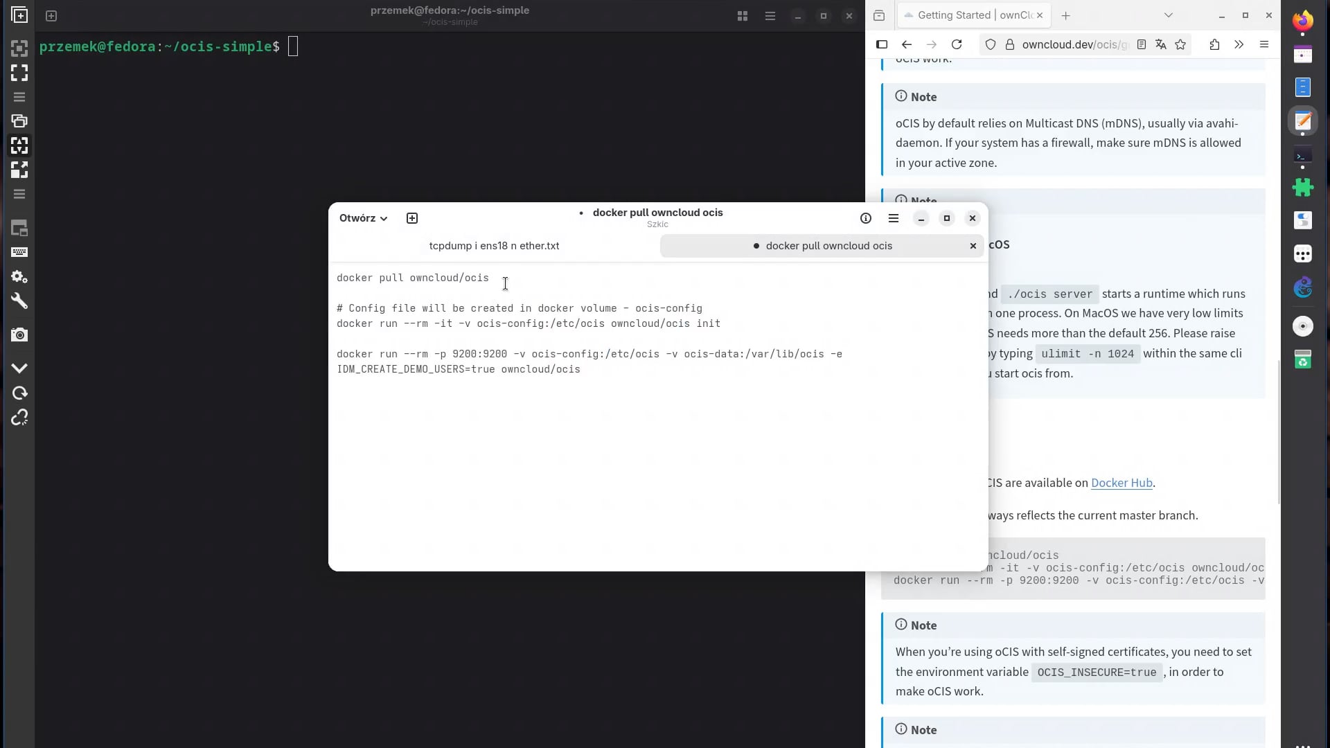

When I’ve been trying out OCIS just to see whether I’d like to invest more time to prepare a proper setup and followed that guide I got it without issues. That being said I don’t know whether I followed the guide to the letter.
First of all - I’d grab latest version of OCIS from the repo.
Then follow the guide to run the init command in the container so the ocis.yaml file will get created.
Then run OCIS in the container with docker command making sure you’re binding the config file to the correct filepath inside container.
Or create a compose.yaml file and run the container with docker compose.
On my end compose.yaml looked like this:

Thanks for reporting this! It does sound confusing. If config.json is required, it would definitely help if ocis init created it by default or if the error clearly stated the expected location. Hopefully this gets addressed soon — clearer guidance would make setup much smoother.
but ocis init does craete config.YAML file if one does not exist :slight_smile: . To quote the docs:
In general, the ocis init command initializes ocis for the first run and creates an ocis.yaml configuration file.
So I don’t know what’s confusing about it :slight_smile: . I might be missing some context here though - I’m quite new to OCIS :smiley: . Let me know how this setup went - as on my end it was pretty much pain free I’ll try to help.
