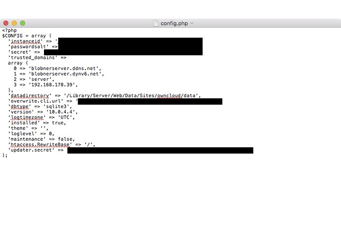

I tried you advice but it didn’t work.
This is my original config.php …

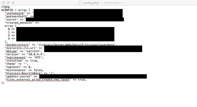

…and when I put the ‘files_external_allow_create_new_local’ => true, in like this…
…the cloud doesn’t work anymore
Probably I am too stupid to do it right. So please be patient with me and explain me what I am doing wrong here

Okay, if you remove that line you cloud works normal, right?
can you copy paste the entries from you config php, removing the sensible information but leaving the commas and single quotes in? I can’t see from your screen shot where the mistake is.

Problem solved.
Thank you very much dmitry. I had to use the terminal and not the TextEdit Programm. So to be honest. I were to stupid to put in one line properly
