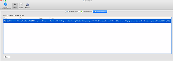

I have installed ownCloud on my iMac computer and it works fine, then I installed ownCloud on my ipage server, created a folder called it (myfiles2) using ftp client (Coda) then I copied (setup-owncloud.php) to the folder and run the install through chrome browser and succeeded, so far so good.
First problem: when I tried to add files from my iMac to the synced folder it start uploading till the end then it gives me an error (screen shot attached):

Expected filesize: Expected filesize xxx got yyy/0

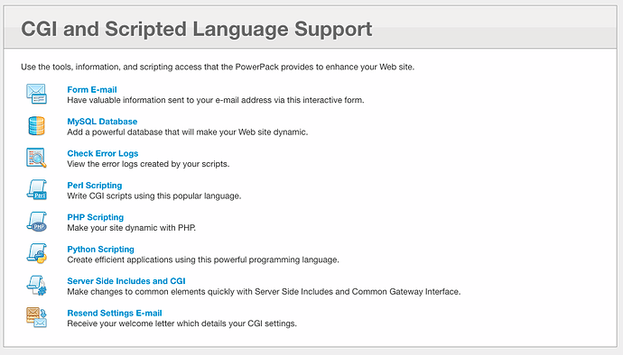

I think I can access to my webserver with cpanel, (screenshot attached)
I entered my log errors in my server and I saw this error
20170404T093319: arabizingdesign.net/owncloud/index.php/login
PHP Fatal error: Call to a member function getRequest() on null in /hermes/bosnaweb04b/b1973/ipg.khsana04/arabizingdesign/owncloud/lib/private/legacy/response.php on line 79
I think you should contact the iPage support about this, sorry.
If they cripple the PHP/setup there is not much we can do to help from here.
In worst case, just rent a cheap VServer, that should work for sure.
