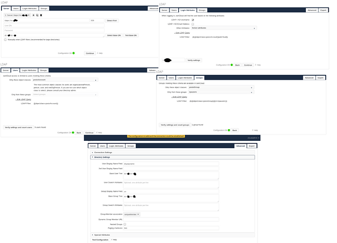

Screenshots, no problem! Please see below, and thank you for your help. I admit I am not very knowledgeable with LDAP but just trying to implement a centralized authentication mechanism for some workstations and web applications on a private network. Note that I can login to my CentOS workstations as well as a web mail application using LDAP without any problems. I marked over the domain information, but other than that what you see is what is there.
Sorry about image size, but the message board will not let new users post more than one image. If you make it full size in your image viewer it will be clear.

The green light means in this case that you can contact the LDAP server, but he is not giving you any information. You could check in the loginfilter tab if you can enter the user cn and if it finds a user with that cn.
