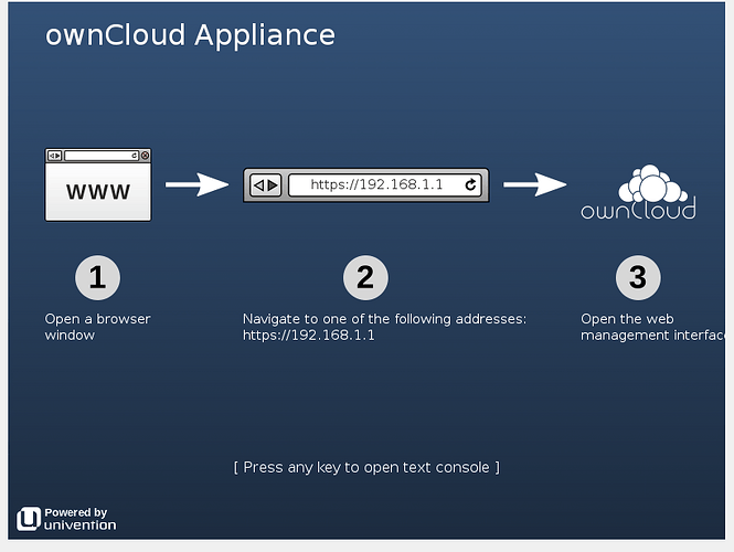

Make sure you did not make a mistake in the address and that your appliance is running, ad has an IP Address.
I just started my Appliance, installed the windows sync client and connected to my Appliance.
Can you post a screenshot of your Appliance?
like this one:
This is the correct IP.

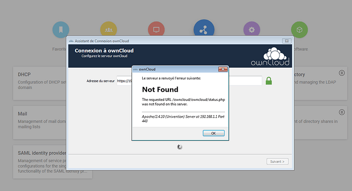

Also can you post a screen shot of the error mesage with IP/owncloud? Because just the IP is wrong.
the screenshot
can you give me a link to this white paper?
I think you have a wrong redirect in your configuration. The Client looks in owncloud/owncloud, that’s one owncloud to much

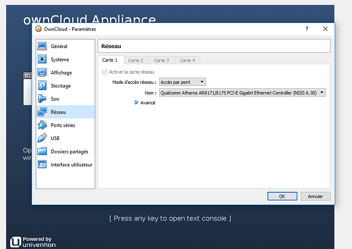

You use Virtual Box, right?
What is the network setting for the Appliance?
I use virtual Box. The config network is
@IP: 192.168.1.1
Mask:255.255.255.0
GW:192.168.1.1
Okay, I don’t know french, but it is set to bridge mode, right?
Also how could your IP 192.168.1.1 be your Gateway 192.168.1.1 at the same time? O_o
Yes, it’s to bridge mode. I haven’t a GW that’swhy i do this.
