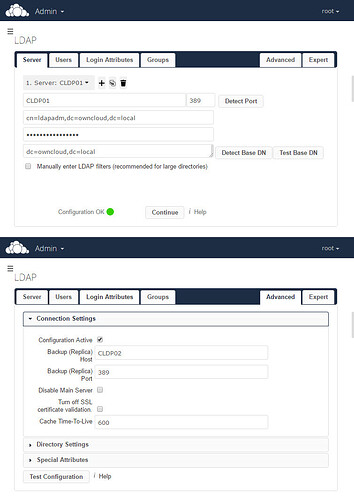

### Steps to reproduce
1. Configured single OpenLDAP server in Owncloud and tested (users can log in)
2. Configured replica OpenLDAP server and tested in OwnCloud (user can log in)
3. Configured OwnCloud LDAP so that the replica server settings in the Advanced tab are set to the second server
4. Turn off the primary LDAP server, try to log in (now using the replica (backup) server). Login fails- see actual behavious
### Expected behaviour
User should be able to log in using the backup LDAP server
### Actual behaviour
User cannot log in

#### LDAP configuration (delete this part if not used)
With access to your command line run e.g.:
sudo -u www-data php occ ldap:show-config
from within your ownCloud installation folder
Without access to your command line download the data/owncloud.db to your local
computer or access your SQL server remotely and run the select query:
SELECT * FROM `oc_appconfig` WHERE `appid` = 'user_ldap';
Eventually replace sensitive data as the name/IP-address of your LDAP server or groups.
| Configuration | |
| hasMemberOfFilterSupport | |
| hasPagedResultSupport | |
| homeFolderNamingRule | |
| lastJpegPhotoLookup | 0 |
| ldapAgentName | cn=ldapadm,dc=owncloud,dc=local |
| ldapAgentPassword | *** |
| ldapAttributesForGroupSearch | |
| ldapAttributesForUserSearch | |
| ldapBackupHost | redacted2 |
| ldapBackupPort | 389 |
| ldapBase | dc=owncloud,dc=local |
| ldapBaseGroups | cn=owncloud,ou=Users,dc=owncloud,dc=local |
| ldapBaseUsers | cn=owncloud,ou=Users,dc=owncloud,dc=local |
| ldapCacheTTL | 600 |
| ldapConfigurationActive | 1 |
| ldapDynamicGroupMemberURL | |
| ldapEmailAttribute | mail |
| ldapExperiencedAdmin | 0 |
| ldapExpertUUIDGroupAttr | |
| ldapExpertUUIDUserAttr | |
| ldapExpertUsernameAttr | uid |
| ldapGroupDisplayName | cn |
| ldapGroupFilter | |
| ldapGroupFilterGroups | |
| ldapGroupFilterMode | 0 |
| ldapGroupFilterObjectclass | |
| ldapGroupMemberAssocAttr | uniqueMember |
| ldapHost | CLDP01 |
| ldapIgnoreNamingRules | |
| ldapLoginFilter | (&(|(objectclass=posixAccount))(uid=%uid)) |
| ldapLoginFilterAttributes | |
| ldapLoginFilterEmail | 0 |
| ldapLoginFilterMode | 1 |
| ldapLoginFilterUsername | 1 |
| ldapNestedGroups | 0 |
| ldapOverrideMainServer | 0 |
| ldapPagingSize | 500 |
| ldapPort | 389 |
| ldapQuotaAttribute | |
| ldapQuotaDefault | |
| ldapTLS | 0 |
| ldapUserDisplayName | cn |
| ldapUserDisplayName2 | |
| ldapUserFilter | (|(objectclass=posixAccount)) |
| ldapUserFilterGroups | |
| ldapUserFilterMode | 0 |
| ldapUserFilterObjectclass | posixAccount |
| ldapUuidGroupAttribute | auto |
| ldapUuidUserAttribute | auto |
| turnOffCertCheck | 0 |
| useMemberOfToDetectMembership | 1 |
### Client configuration
**Browser:**
Chrome 56
**Operating system:**
Windows 10
#### ownCloud log (data/owncloud.log)
[root@nnnnnn ~]# cat /data/octest/owncloud.log | grep WNpAuktqk8x@yWV655AG3wAAAAU
{"reqId":"WNpAuktqk8x@yWV655AG3wAAAAU","remoteAddr":"10.1.10.n","app":"index","message":"Exception: {\"Exception\":\"OC\\\\ServerNotAvailableException\",\"Message\":\"Lost connection to LDAP server.\",\"Code\":0,\"Trace\":\"
#0 \\\/var\\\/www\\\/owncloud\\\/apps\\\/user_ldap\\\/lib\\\/LDAP.php(257): OCA\\\\User_LDAP\\\\LDAP->postFunctionCall()\\
n#1 \\\/var\\\/www\\\/owncloud\\\/apps\\\/user_ldap\\\/lib\\\/LDAP.php(43): OCA\\\\User_LDAP\\\\LDAP->invokeLDAPMethod('bind', Resource id #591, 'cn=andrew jones...', '***********')\\
n#2 \\\/var\\\/www\\\/owncloud\\\/apps\\\/user_ldap\\\/lib\\\/Connection.php(600): OCA\\\\User_LDAP\\\\LDAP->bind(Resource id #591, 'cn=andrew jones...', '***********')\\
n#3 \\\/var\\\/www\\\/owncloud\\\/apps\\\/user_ldap\\\/lib\\\/Access.php(1308): OCA\\\\User_LDAP\\\\Connection->bind()\\
n#4 \\\/var\\\/www\\\/owncloud\\\/apps\\\/user_ldap\\\/lib\\\/User_LDAP.php(137): OCA\\\\User_LDAP\\\\Access->areCredentialsValid('cn=andrew jones...', '***********')\\
n#5 [internal function]: OCA\\\\User_LDAP\\\\User_LDAP->checkPassword(*** sensitive parameters replaced ***)\\
n#6 \\\/var\\\/www\\\/owncloud\\\/apps\\\/user_ldap\\\/lib\\\/User_Proxy.php(67): call_user_func_array(Array, Array)\\
n#7 \\\/var\\\/www\\\/owncloud\\\/apps\\\/user_ldap\\\/lib\\\/Proxy.php(139): OCA\\\\User_LDAP\\\\User_Proxy->walkBackends('ajones', 'checkPassword', Array)\\
n#8 \\\/var\\\/www\\\/owncloud\\\/apps\\\/user_ldap\\\/lib\\\/User_Proxy.php(182): OCA\\\\User_LDAP\\\\Proxy->handleRequest('ajones', 'checkPassword', Array)\\
n#9 \\\/var\\\/www\\\/owncloud\\\/lib\\\/private\\\/User\\\/Manager.php(200): OCA\\\\User_LDAP\\\\User_Proxy->checkPassword(*** sensitive parameters replaced ***)\\
n#10 \\\/var\\\/www\\\/owncloud\\\/core\\\/Controller\\\/LoginController.php(177): OC\\\\User\\\\Manager->checkPassword(*** sensitive parameters replaced ***)\\
n#11 [internal function]: OC\\\\Core\\\\Controller\\\\LoginController->tryLogin(*** sensitive parameters replaced ***)\\
n#12 \\\/var\\\/www\\\/owncloud\\\/lib\\\/private\\\/AppFramework\\\/Http\\\/Dispatcher.php(159): call_user_func_array(Array, Array)\\
n#13 \\\/var\\\/www\\\/owncloud\\\/lib\\\/private\\\/AppFramework\\\/Http\\\/Dispatcher.php(89): OC\\\\AppFramework\\\\Http\\\\Dispatcher->executeController(Object(OC\\\\Core\\\\Controller\\\\LoginController), 'tryLogin')\\
n#14 \\\/var\\\/www\\\/owncloud\\\/lib\\\/private\\\/AppFramework\\\/App.php(99): OC\\\\AppFramework\\\\Http\\\\Dispatcher->dispatch(Object(OC\\\\Core\\\\Controller\\\\LoginController), 'tryLogin')\\
n#15 \\\/var\\\/www\\\/owncloud\\\/lib\\\/private\\\/AppFramework\\\/Routing\\\/RouteActionHandler.php(46): OC\\\\AppFramework\\\\App::main('LoginController', 'tryLogin', Object(OC\\\\AppFramework\\\\DependencyInjection\\\\DIContainer), Array)\\
n#16 [internal function]: OC\\\\AppFramework\\\\Routing\\\\RouteActionHandler->__invoke(Array)\\
n#17 \\\/var\\\/www\\\/owncloud\\\/lib\\\/private\\\/Route\\\/Router.php(280): call_user_func(Object(OC\\\\AppFramework\\\\Routing\\\\RouteActionHandler), Array)\\
n#18 \\\/var\\\/www\\\/owncloud\\\/lib\\\/base.php(891): OC\\\\Route\\\\Router->match('\\\/login')\\
n#19 \\\/var\\\/www\\\/owncloud\\\/index.php(54): OC::handleRequest()\\
n#20 {main}\",\"File\":\"\\\/var\\\/www\\\/owncloud\\\/apps\\\/user_ldap\\\/lib\\\/LDAP.php\",\"Line\":284}","level":3,"time":"2017-03-28T10:53:47+00:00","method":"POST","url":"\/index.php\/login","user":"--"}
