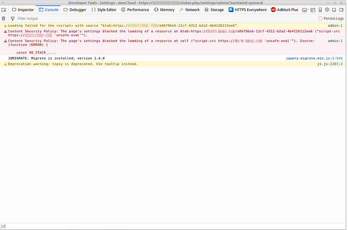

Thank you very much for the response and the patch. I changed the code manually. I suppose that was not the best method. I still cannot add any external cloud and additionally I have the following error in the console:
How can I solve this?
