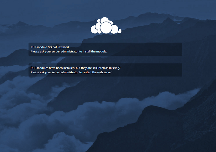

1.When i try to load my owncloud page I get the following error screen.(attached image)
2.I have verified that I have php7.0-gd and php-gd installed.
3.I have loaded php.info from my webserver and didn’t see any errors

It loads an error page saying that GD is not installed.

That screen is the same as the main screen with the GD not installed message.
