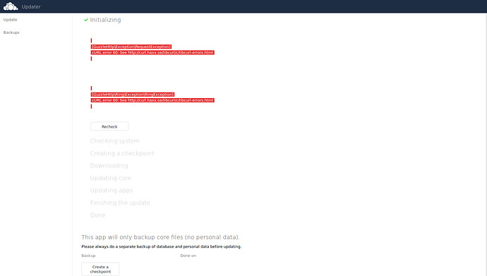

I cannot update my owncloud instance.
When I log on, I am greeted with
I go to the Admin page and click on “Open Updater” where I get:
Current version is “ownCloud 9.0.8 (stable)”
