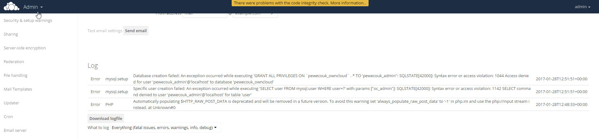

When I import a calendar it works perfectly - however if I try to import an addressbook it fails (ie nothing happens when I select the .vcf to import) and an error appears in the log.
Can anyone advice where the problem may be.

I have updated the OP to include the integrity error.
Ok, I hear what you say regarding the Versioning of OC/NC, but that does not explain why I could be getting import errors in OC9.1.3 - particularly as the import works for .ics files with no database errors, but not for a .vcf file originally exported from a copy of OC9.1.1.

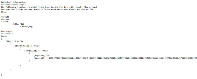

I am still looking for a solution to the integrity check error - just as a refresher this is what appears when I list the files causing an error
I cannot find the file in question so any pointers would be appreciated.
The file is located in your main ownCloud installation dir. If its not there please follow the link in the message within your admin backend which leads you to the documentation explaining how to continue solving this message.
It won’t go away automatically once the file was deleted and you need to rescan your files as explained in that mentioned message and in the documentation.

I found and deleted the file - but when the new one was created and after a re-scan, the error was still there.

if your webservers configuration is always placing this file at that location the issue will happen again and again. So thats why moving the installation to another place is now working without this issue.
