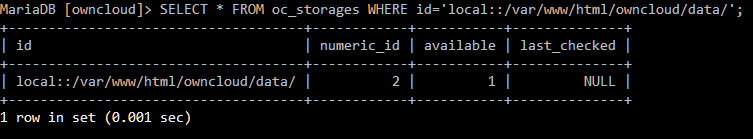

Gives following error
afbeelding
All the other steps worked without errors. Everything seems to work and it looks like data is transferred to to right location.
Someone who knows what the problem is here?
Can you run the following select?
SELECT * FROM oc_storages WHERE id='local::/var/www/html/owncloud/data/';

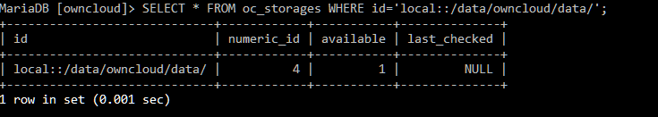

Can you also run:
SELECT * FROM oc_storages WHERE id='local::/mnt/owncloud/data/';
So ID is the primary key of the table(?), and I would guess somehow that there is already an entry with the new path. So potentially you could just delete that row? Perhaps @jvillafanez can chime in?
Anyone an idea? I just want to be sure it’s safe to use it like this.
OK, so. I re-read the instructions, and I guess you’ve added the datadir directory in your config.php before you started doing these steps, so ownCloud already created that entry in oc_storages. Can you confirm that?

This is indeed the case. The outcome of the commands:
