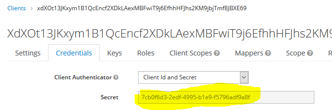

This is my keycloak’s configuration for client desktop
The secret needs to be “UBntmLjC2yYCeHwsyj73Uwo9TAaecAetRwMw0xYcvNL9yRdLSUi0hUAHfvCHFeFh” in Keycloak. This can be achieved only by importing. If you import the file I linked, it will be right. You cannot change it on the Desktop Client side.
[SOLVED] PERFECT!!! I dont understand in your previous message that i must use the “SECRET” mentioned. So far so good…
