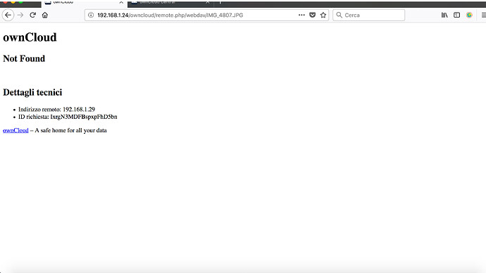

I can not understand what I should do to be able to see the data, currently if I click on any data I see this screen:

Can you search the owncloud.log for the Request ID in your screenshot?

The RequestID from your screen shot starts with IxrgN3
on the file that I downloaded is not present … but the log file is downloaded from “settings”?
You can set the log level to 0 in the Settings, and try to perform an action where you will have an error, and download the log file then, and look for the error code.
I clicked on a file qualuqnue to receive the error screen posted above and the result is this

I have noticed something, the IP in your browser is .24 but the error is telling you that under .29 it has not found ownCloud. Did you change something on your web Server configuration?
Try typing your servers IP in your browser and see if the apache2 start
page comes up
if I type only the ip, then without / owncloud, it redirects me directly to the owncloud login page
trying to change ip does not load the apache page
