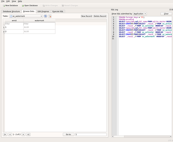

I still confused about the answer. Following screen shot will explain my complete question. I have table named as “oc_watermark”. Now I want to access the filed “watermark” against “wmid”. I have to write the select statement code in “upload.php” file.
I have searched that this can be like this:
select watermark from oc_watermark where wmid=1;
How can I use above select statement using “SystemTagManager.php”?:confused:

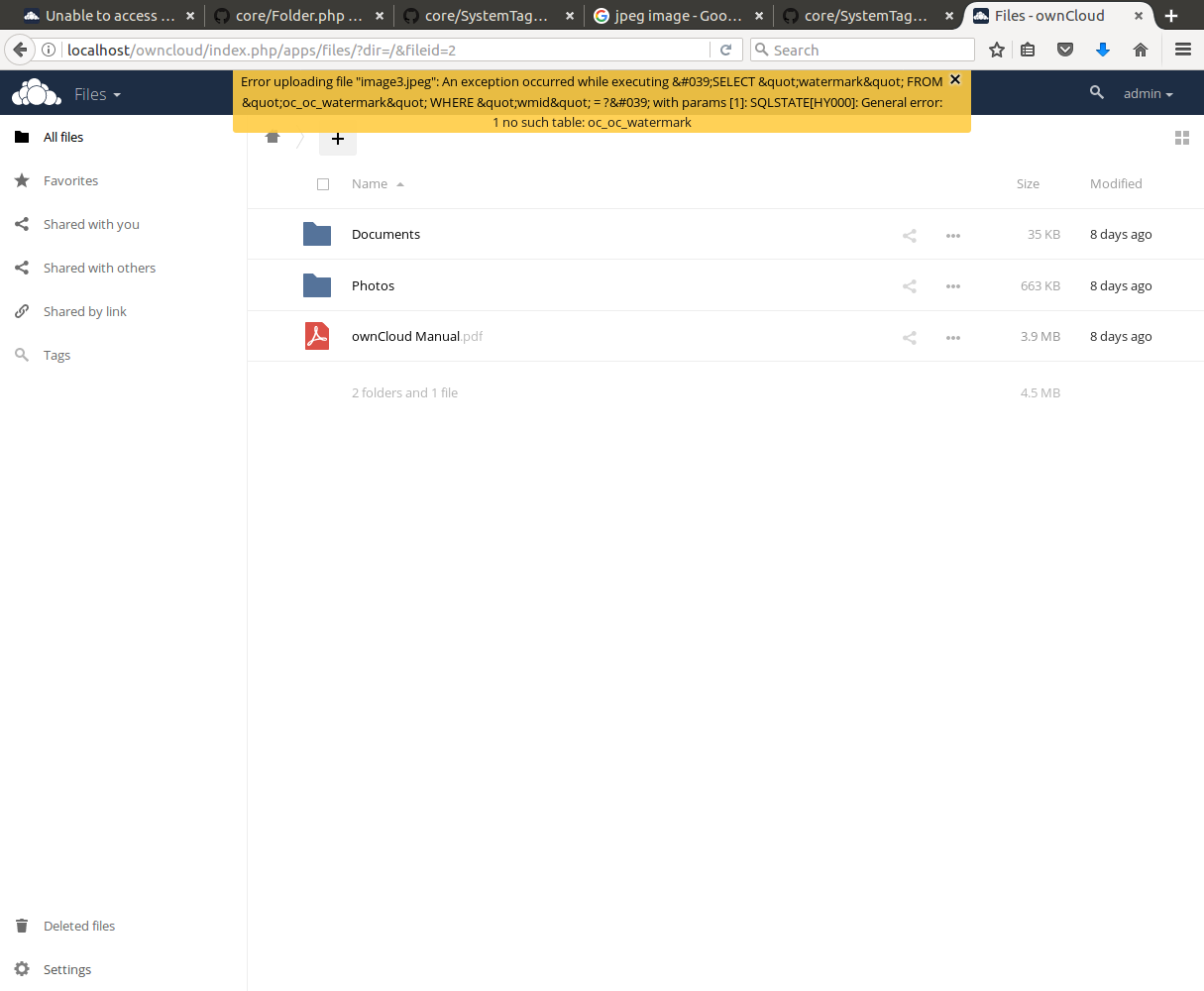

But Now while selecting image from “oc_watermark” I m getting the following error? How can I get rid from the following error? :confused:
If you look closely at the error message it says “no such table ‘oc_oc_watermark’”.
In my snippet I added a comment that no prefix is needed so remove the “oc_” from the from() clause.
