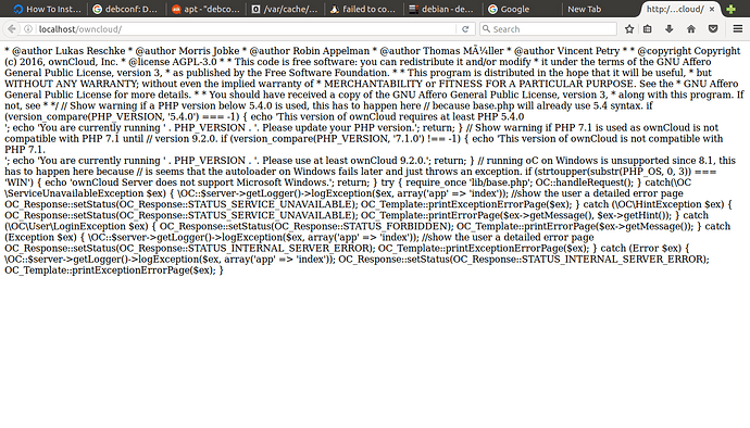

When I write the http://localhost/owncloud/ in browser then i got the following error.
How to fix this?

To solve your issue you need to install and enable PHP for your webserver.

Now I have installed PHP. When I am checking PHP version from terminal terminal using PHP -v
so I being shown following output, which means that I have installed PHP successfully, but still m facing the same problem.

How to solve it now?
this is still a webserver configuration problem were you havn’t activated PHP in your webserver. A short search on the net should guide you to posts like e.g.:
