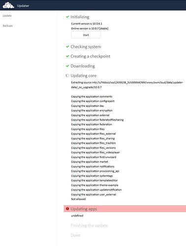

Hello, I just tried to use the updater function to update owncloud server on my Host Europe environment from 10.0.6 to 10.0.7.
First of all I get the famous error: cURL error 7 … , with which a lot of users are struggeling.
The fix in this post: Update von 10.0.2 auf 10.0.3 nicht möglich - #6 by ViSol helped me to finally start the updater (Many Thanks to ViSol :grinning:)
But the updater does not get through and freezes with the following screen:
Has anybody an idea what has gone wrong and can help?
P.S. Please do not recommend a manual update - I know that this works, but it takes so much time&preparation. Normally the updater should be working!
The screenshot shows a “Not allowed” at the end. Maybe your hoster is blocking some required methods or has some stricter rules / configuration so that the “Normally the updater should be working” can’t work at that hoster and doing the manual update is the only way?
