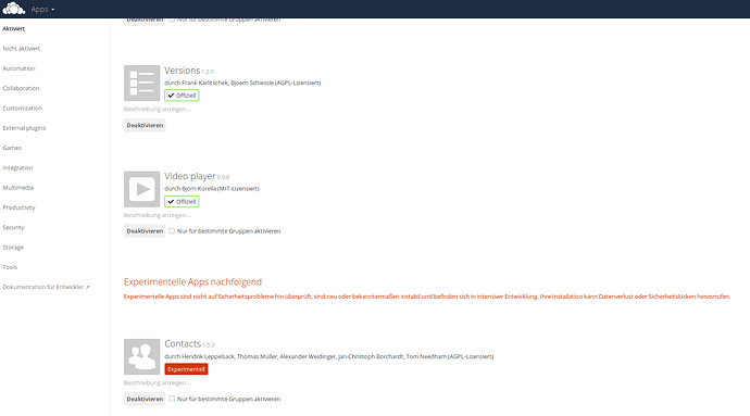

Screenshot from activated and funcionally app contacts wich is marked as experimentally.

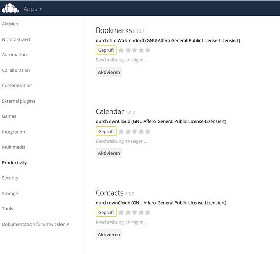

Screenshot from deactivated app contacts wich is marked as being proofed. - If i try to deactivate the experimental one and activate this one, a message that contacts allready exists is thrown.
In mind that with 9.1 major changes will be make with the contacts, im not sure if can go thru update 9.1 without fixing that issue in 9.0.
Why not just upgrading to ownCloud 10? From what i understand whats written in the linked blogpost this is just a compatibility mode of the new marketplace. And then you probably can hit slightly different / unexpected behaviors.

I think you can just remove the /apps/contacts folder and re-install the app again via the marketplace.
Ok, i did first deactivate the contacts app, wich was marked as experimental, then i deinstall it, with the effect, that the folder contacts in app folder vanishes. The i activate the proofed app contacts and all went fine. Thx for help.
