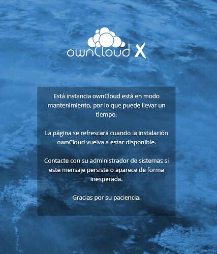

I updated 10.0.8.5 to 10.0.9 The update process doesnt gave me any error (web updater) but when i want to enter to owncloud a screen with maintenance mode appears…
I search in the forum for this error but appears commands for linux and i have my owncloud in a vps with centos 7 and i dont know how to write the exact command to put maintenance mode off. (i ve just know a few commands, im a rookie user). Can anybody tellme the exact command for centos 7 to put maintenance mode off?
Sorry about my english but im a spanish speaker.
I take a snapshot (its in spanish)

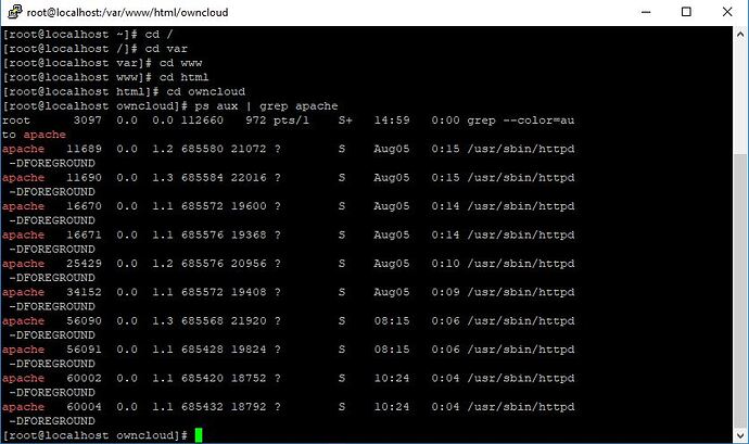

Then your webserver is running with another user than www-data.
Try this:
ps aux | grep apache
i write the command you give me and this is the result

The command I gave you does not fit - your web server user is not www-data but apache.
so replace www-data with apache in my command and execute it.
sudo -u apache php occ upgrade -vvv
