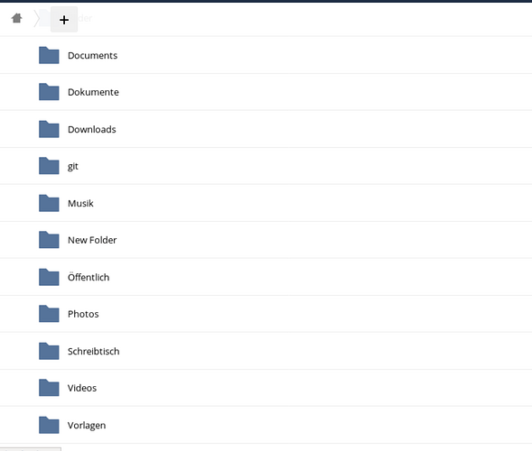

I have just tested something, don’t know if it’s that what you want.
I have installed the sync client on my ubuntu system. While setting up the client, I choose my home folder as the sync folder with the option of keeping existing data.
Now I get all the files and folders synced in ownCloud without having to duplicate my files on upload.
If I don’t want all my folders synced, I can unselect them from sync.
thanks! this is a sensible solution.
